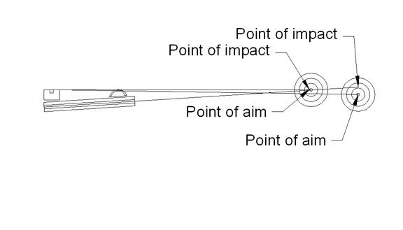

mt: I heard that shorter barrels need a taller front sight but not sure why. Is it because the shorter barrel rises more quickly under recoil? I would be interested to find out. In regards to my SBH, I have a Weigand insert type ramp installed so I can change blades at will. Right now using my handloads for 44mag and some 44 special loads, my Ruger shoots low ( with the factory height sight, so I am using a .200 height blade for the time being. I probably will leave the barrel as is but I seriously considered sending my Colt New Frontier to a competent barrel smith who could do a new 5 1/2 or six inch barrel since I don't like the 7 1/2 inch barrel or the crummy red insert someone installed before I got it, it's a long story for another time. Chris
I wouldn't lie to you, I'm not an expert. My 45 Colt was shooting high with the rear sight bottomed out. I had the taller front sight blade installed and I now have plenty of vertical adjustment with the rear sight.

Taller front sight would lower the muzzle from the line of sight between the rear sight and the target, thus the lower point of impact, all other things being equal. Draw a sketch.

Gotcha on sight picture for front sight height. But, why do short barrels shoot high? I understand why a front sight would need to be higher if the gun is shooting high but can't get my head around the reason a short barrel would shoot higher than a long barrel. Does the shorter barrel jump up faster? Or, is it a mathematical deal with distance between sights or something? I seem to be in "Zheimers Zone" again over this. Chris

Hi Trigger happy: I have a 6 inch barrel on my Python and really like it too. My Super Blackhawk has the 7 1/2 inch tube and I often wish it was about an inch shorter or even down to 6 inch. That is probably not a big deal just personal preference. I still haven't figured out sight height to my satisfaction but I did read somewhere that the rear sight height set at middle of adjustment should be equal to the height of the front sight. That's above line of bore. I don't know who figured that out but it may be a good rule of thumb. I welcome any technical explaination of sights on handgun barrels and proper height. I do know that Elmer Keith said longer barrels often shot to different places more often than short barrels and he speculated it had something to do with time of bullet travel down the longer barrel and the amount of rise from recoil. Chris
