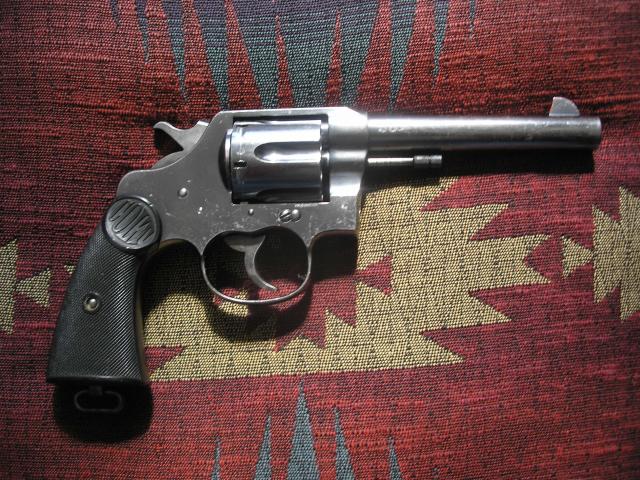

Here she is...
Very nice Mak! How does it shoot now? Chris
That's a great looking old Colt. Looks like fun.
Brian
Hi Mak, was referring to the extractor and cylinder now if you fixed it, not how accurate it is. Chris
Will provide pertinent details as time allows.

The good news is that for once I guessed right, and the extractor alignment seems pretty darn close to perfect. Did have to resort to very light filing on the extractor of the problem chamber. Did so by first smoking two resized brass cases, and following where the smudge was scraped off. Both showed significant scraping along the cylinder wall-opposite of the extractor. I figured that this meant the extractor was pushing the brass against the outside of the chamber. About 20 min. of careful filing, to evenly remove just a little metal at a time, and then hand fit has resulted in the chamber happily accepting resized brass without a hiccup.
Checking just a little while ago, everything is green for an actual shoot-as soon as I get the time.
