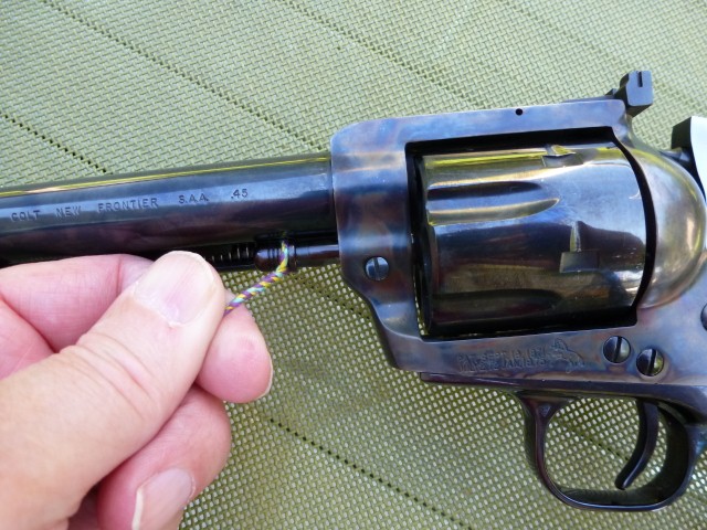

I like to clean my guns quite often, unlike some people who like their guns dirty (AL?), but I do often shoot several boxes of ammo before getting to the fun job of cleaning. I recently was going to pull down my New Frontier but the basepin was a little stuck. I have a nice Belt Mountain pin that fits great and it usually slides right out but the ammo I had been shooting was a bit on the dirty, sooty side so this time the pin wouldn't do more than just budge a tad. I used some Kroil and let it sit for a while as I looked for my nylon punch and hammer. I was going to tap the back of the pin in front of the hammer. I couldn't find the punch I wanted and decided some alternative to prying on my nice blue finish with a tool was in order. I found some string, actually some yarn as the colors show, and slipped the string around the pin and twisted it tight and some gentle pulling moved the pin right out with nary a problem. I didn't even have to remove the crosslock. Chris

It's fun to see somebody come up with a simple idea to solve a problem. I got a couple of base pin pullers with my sixguns.

Nice tip Chris.
