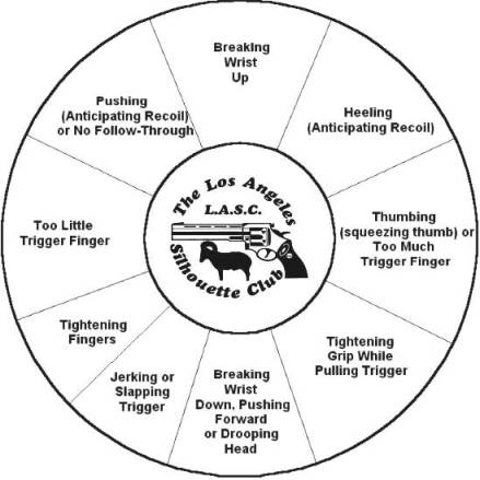

The guns ran well mechanically, but I have to admit I am not not likely to be accused of being a sharp shooter any time real soon. It did not matter who the shooter was (there were two of us present) the guns both seem to shoot low and to the left from point of aim. I am thinking this is probably our problem as niether of us have a whole lot of revolver shooting experience - yet! The grips on these guns are the original Ruger grips (black plastic checkered type), and they seemed a might bit thin from the first time I picked the guns up, and I will be looking into different grips right away. Also I have a slight astigmatism issue in my right eye which makes sight line focus a challenge with the narrow rear notch site on the Ruger's. I am thinking maybe a trip to the gunsmith is in order to widen the rear notches just a little.

So, Kidd. You got lots of shooting done. Here is a chart that has helped me with correcting my grip on a revolver.
You might print it out and see if changing your grip might help before you make changes to the gun. Also, I think I would deside on a standard load because different loads are going to shoot to different points.

Howdy All. Thought I would post an update on the Rugers. Also wanted to thank mwworkmastersr, for the chart that you posted, it helped alot.
We have also been taking a few lessons from one of our SASS club member's on handling SA's and that has helped us alot too.
We now have over 500 rounds thru each gun, and can report that we can reliably hit the steel plates most every time. We are shooting cowboy loads now instead of commercial ammo, and there is definately a big difference in point of aim. Just need to fine tune the powder charge a bit more, but that will happen. I do notice that I need to load the rifle ammo a bit heavier, than the pistol ammo, as the pistol ammo in the rifle is not as accurate.
