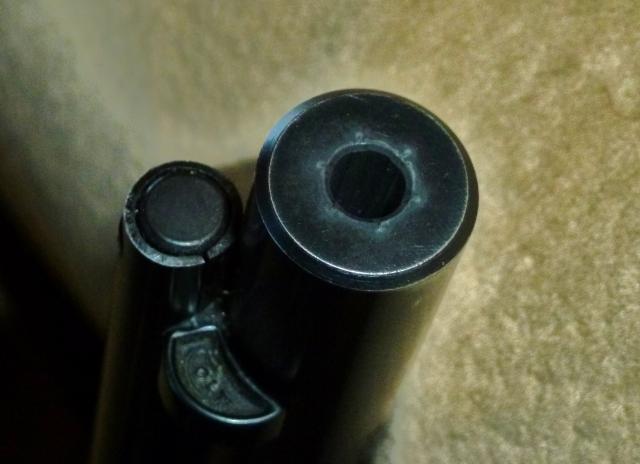

I took this picture of my Colt Scout muzzle to show what a good crown looks like. Aside from the blurry photo quality, the thing to look for is the equal distribution of powder residue at each land and groove. In this case a neat 6-point star. On a big bore it's a little harder to see but if you look close you should see if your barrel is properly crowned or slightly off. Chris

Is that the eponymous half-moon ejector piece?

It is the original one that came with the gun. It could be a quarter moon if I want to really be precise. Chris
