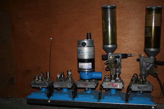

5.56, .454/45 Colt, .223, 308, .22 Hornet
.38/.357, 9mm, 308 trimmer, .338/340, .40SW
44 mag, 45/70, .45ACP, 7.62X39
The Beast.
Any Questions?

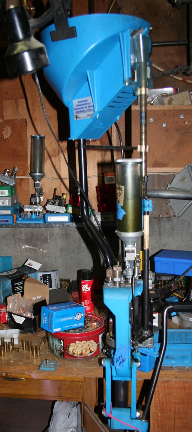

Showoff! Are you qualified to operate that machinery? I thought we were talking "HANDLOADING" not factory production. I still use a hand held Lyman "Nutcracker" loader or a small RCBS benchloader special that looks like a miniature O-Press and clamps to a range table. I weigh each charge and seat each bullet, all by hand, hence, "handloads.....Chris
I use my hands to operate the press!

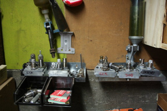

The Dillon is capable of producing premium rifle loads at a reasonable rate, and mass producing range ammo. For the rifle I run the brass through lubed up to beat $hit and just size on the first pass, for the 308 I use 2-3 sizing dies depending on the brass, clean the lube off and then run them through to prime, charge, seat, and mil style crimp. (Lee Factory Crimp Die) Same w/ the 5.56 and Hornet.
The mag rifle loads are the only rounds I don't use the case feeder on, other then that similar to the other rifle loads except I throw the charge, then pull from the press, trickle them to precisely the correct charge, and then seat, crimp, and mil style crimp. ( .338 WinMag, 340 WBY, and 45/70 GOVT). Nice having 4-5 die stations, even for low production rounds.
Precision .357, .44 Mag, .45 Colt Mag, and .454 Casull I Prep/Lube/Size several hundred cases, polish the lube off, sort by length, and load the largest consistent group, saving the rest for "Range Ammo". The rest, range pistol, revolver, and carbine, polish the brass, dump 500 rounds in the case feeder, fill 5 primer tubes, dump 500 bullets on the tray, (with my hands), dump a pound of powder in the measure, (with my hands), and start cranking rounds out (with my hands). Easily get 500 rounds / hr of 9mm, .38, .40, .44, .45 including caliber change (with my hands)....
The Dillon throws powder accurately from 3 grains (or less) up to 80 (or more) grains plus or minus a couple tenths, only problem I run into is it's to fast for bottle neck cases and extruded powder, have to give it the "1001, 1002" count between cranks of the handle or it spills the last of the charge all over. .
I use a fine ball powder in the .556 range ammo to avoid that, but just have to take my time with the Mag Rifles.
