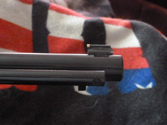

I was having a devil of a time trying to get these old eyes to adjust to the old bent blade on my .22 Scout to get windage right by guess and decided to hell with collectability! I dovetailed a new front sight and now can adjust windage to get those shots where I want them to go. Took a bit of calculating to get the right height for the insert but it is done. All you Colt lovers don't hate me! Chris S

It's a good looking sight, and after all, the purpose is to hit the rascal where you point. Good on ya.

Finally got a chance to shoot it and adjust the sight to POA and it works great! I will shoot it a few more times to be sure and then put a drop of epoxy on each side just to keep it there. Chris S

Looks good and now shoots good.
