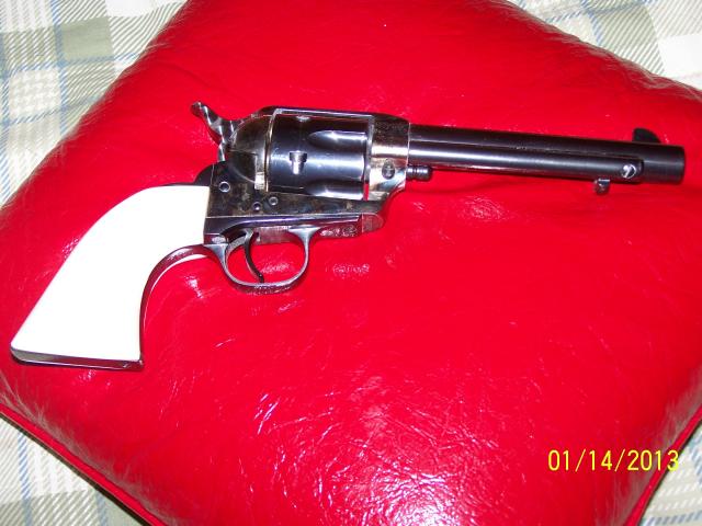

I went to the local hardware store this afternoon in search of 600 grit wet/dry paper. The best they could do was 400 grit of which I have plenty. However, when I was explaining why I wanted such a fine grit, and old geezer, even older than me, piped up and suggested 0000 steel wool as he had used it successfully on rifle stocks. I have used it, too, on muzzle loaders I have built. So, I skeedaddled home and scrubbed away with it. Shined up the grips nicely, so I put on a coat of Trewax and called it good.
Now, if I could just remember how to upload a photo...

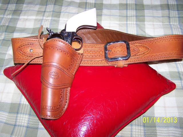

Leather by David LaFlair of Cochise Leather. For me, this is the Perfect Packin' Pistol now. I carry it everywhere. I drops right into my jeans pocket, and the ivory feels SO NICE. I think I will work on geting this done for all my revolvers, but I will let somebody else do the work. Doing one is fun, but repeats would be weary.
