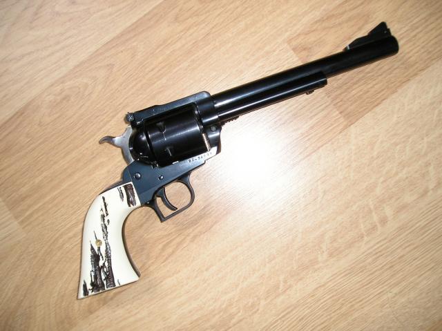

P.S. I soldered this new ramp on my SBH and it slightly discolored the blue right in front of the ejector housing if you look close. It is a working gun so I wasn't worried about a little blemish but if it was on my Colt New Frontier I would be worried.
