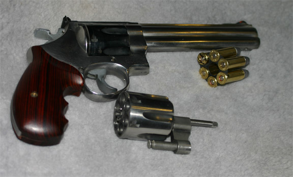

Been about a year and a half since Gunny rebuilt my 629 classic, 500 rounds or so of full blow loads and several thousand plate loads, still tight as ever. Compared it at the last Keith shoot to a slightly used Performance Center revolver and a like new M29, end play and side movement equal to or better then the PC and noticeably better then the new stock gun.
Work Gunny performed:
Smoothed and times action, installed custom make cylinder shim kit, and set headspace to 60 thou.
Fit frame and cylinder fit so that the cylinder is 100 percent in contact with the frame at the center ring on the star.
Fit new Ahern grips.
Sharpend checkering on hammer, backstrap,forestrap,thumb cylinder release.
Lapped the barrel, opened the cylinder up to 431 diameter on both cylinders, Timed both cylinders and fit the cranes to the gun to match the frame, and timing.
Double action pull is 10 pounds, and single action is 3 pounds.
Barrel fitted to exact center, with rear sight centered, and adjusting screw aligned with the other screws, at 25 yards. Then the barrel is pinned in place.
All the screws are aligned so that if the screws come loose, you can see it instantly and tighten. Smiths all loosen with use.
Hammer shim set
Trigger shim set
Fitted oversized pawl
Fitted oversized cylinder stop
Barrel removed, forcing cone re-cut to 11 deg.
Barrel crown recessed and re-cut to 89 deg.
Cylinder set to .060 headspace
Barrel set in and matched to cylinder .002 forcing cone gap, +- .0005
Cylinder base pin shortened to match new barrel position
Barrel pinned
Since that time I have installed a lighter spring set and shaved another .001 off the front of the blued moon clip cylinder as I tend to shoot that one a lot between cleaning, needed a little more tolerance for the build up.
