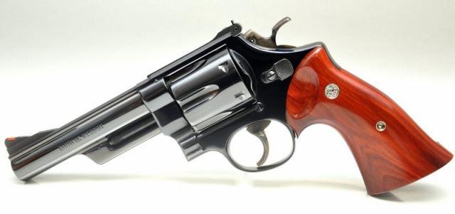

I will try to make it a simple question. How much is too much? I loaded up some 180gr XTP HP and get 1,430fps @ 817ft/lbs of energy. Is this too much? Will go through an attacker (human)? I hear all one needs is 12-15 penetration on ballistics gel. No more no less.
