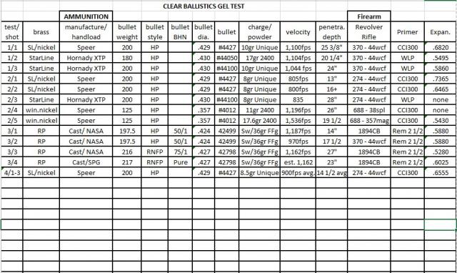

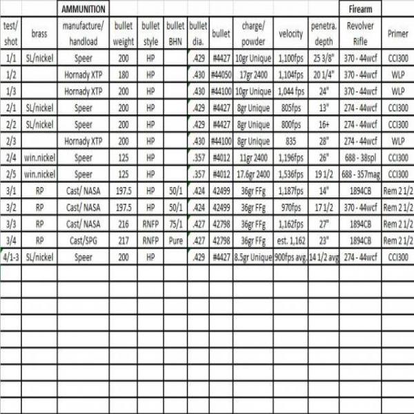

First three tests

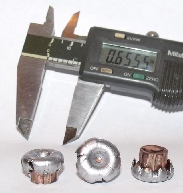

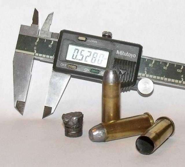

Lets see if I can get this right.
Shot #1 - FAIL - too fast
StarLine Nickle Brass
200gr GDHP
CCI Primer
7 1/2 Barrel
17gr 2400
25 3/8" Penetration
1,100fps
Shot #2 - Fail - too slow for proper expansion?
StarLine Brass
180gr GDHP
WLP Primer
7 1/2 Barrel
17gr 2400
20 1/4" Penetration
1,104fps
Shot #3 - Fail - I think it could expand a bit more but looks like it will make a good hunting load.
StarLine Brass
200gr Hornady XTP
WLP Primer
7 1/2 Barrel
10gr Unique
24" Penetration
1,044fps
Muzzle 10ft from Gel front
