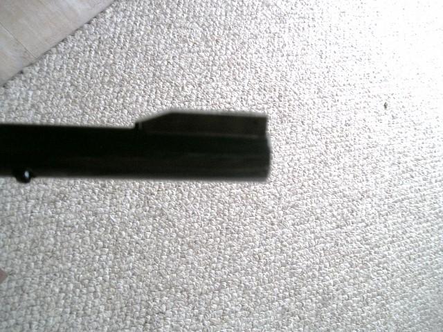

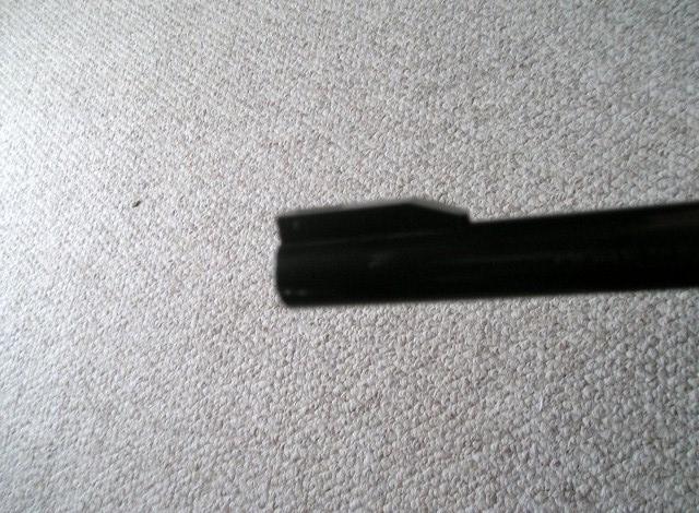

These are not good pics of the ramp but if you look close you can see a faint line along each side of the ramp where the solder flowed. I also just used a new blueing product to see how it works, Blue Wonder. I'll let you know if it comes out ok. Chris
