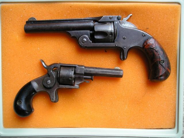

Gunsmith, I know many people will think me silly, or even a poor unfortunate, but I have never owned a Smith, except for the old single action 32 that my great grandfather owned. I posted a pic of it somewhere on here, maybe under open topic or rants, therefore I cannot comment on the lack of quality on the newer ones but I can offer an opinion, they almost went bust, a conglomerate bought them and then the former employees or someone, bought what was in shambles and they probably have had to make a lot of cost cutting measures. Just another story of how once great American companies have been ravaged by the throw away economy and the desire to have everything on a global economic scale. I am not qualified to offer an opinion on the future. Chris
What a shame. To be down to only 1 Smith. At least it is an old one. Only fire it with black powder loads. That means only reload for it. When you are done shooting, put the brass in vinegar, to neutralize the black powder salts. Works like a charm.

Gunsmith, I found the pic and edited it in my last post. I don't shoot it anyway, it's more of an heirloom from my ancestor and I have enough other guns to shoot. Thanks, Chris

By the way that is a beautiful old Smith. I would fire it with black loads, and see what it would do. You will not hurt it, as long as you clean it and oil it after. I am VERY jealous.
