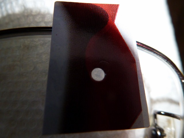

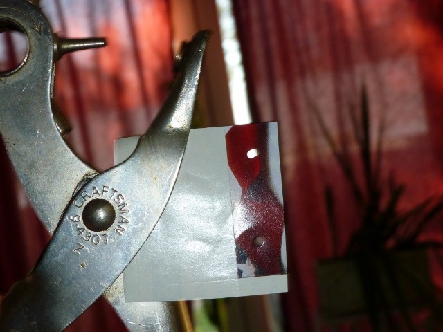

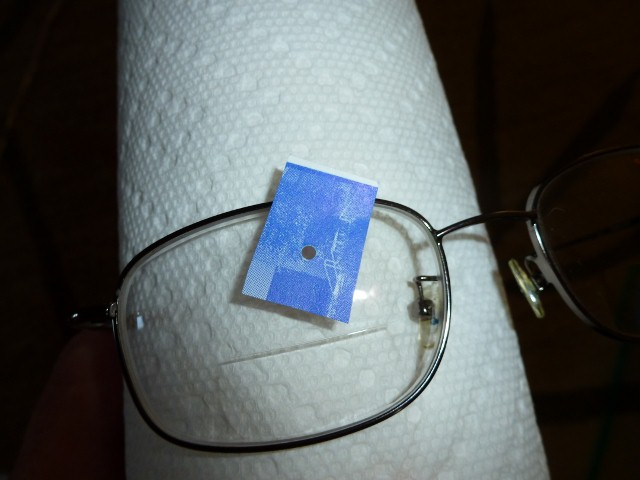

I have an old man's eyes and it is often hard to focus on the open sights of my handguns when I'm target shooting or even just plinking. I was familiar with the old aperature sight discs that can be clipped on glasses but was never interested in buying them for whatever reason, maybe my aversion to spending money! I saw a product a while back that advertised a stick on paper aperature that would do the job of a sight disc. Problem was, I didn't buy those right away and when I decided to try them the company was out of business. Being very industrious I decided to make my own. If any of you are like me, you get stick on address labels in the mail from various organizations and soon have such a stockpile that they get thrown away eventually. I figured if I punched a pinhole or similar aperature size in one of these labels I could stick it on my glasses and it would be the same as a sight disc! In the pictures I show how I used a leather punch to put holes in the label and then stick it on my glass lens. It ain't perfect but it does work and I can attest to how it sharpens the sight picture when I target practice. If any of you are interested try it and it may surprise you. Chris

that looks like a good idea.
for the last several years I have been cutting strips about 1/2 or 3/4 inch wide from coke cans and drilling or punching a 1/16 inch hole in one end.
I bend them over and just slip one over the top of my glasses.
they also slide out of the way.

.......is arbitrary. I used the smallest hole punch on the wheel of the leather punch and it is a hair over 1/16th but any small hole punch will do the job and each user will find what size is best for their needs. Your use of can strips is more permanent than the adhesive labels which I use once and discard when done. Good shooting. Chris

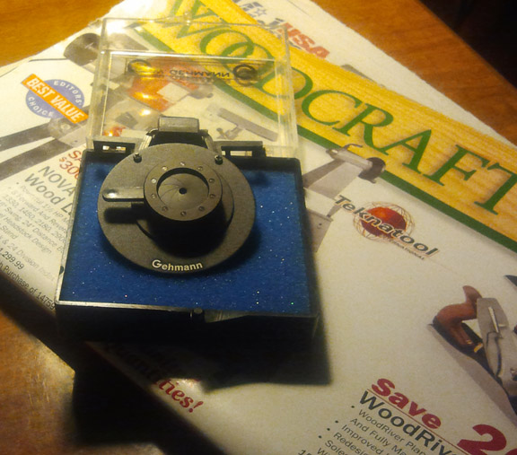

Used this a couple of times:
